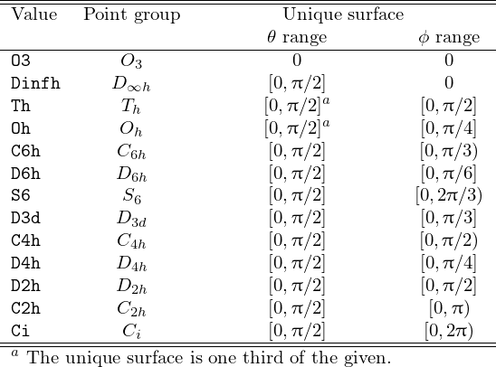

Symmetry specifies the symmetry for which the grid is to be generated. The higher the symmetry, the smaller can the needed sphere surface be, since rotational and reflectional symmetry makes parts of the surface redundant for EPR calculations.
Since all spectra in EPR are invariant with respect to inversion of the system, only centrosymmetric point groups are supported. For each point group, sphgrid returns a grid only over its unique surface. The following table lists the possible values for Symmetry together with the unique surface boundaries.
[eqn]
Note that some unique surfaces have open φ borders. This is treated correctly by sphgrid. There are never knots on open borders. nKnots determines the number of knots on the quarter meridian θ = [0, π/2], φ=0. The number of knots along the equator depends on the range of φ. Roughly, nKnots are taken for each quarter of the equator.
