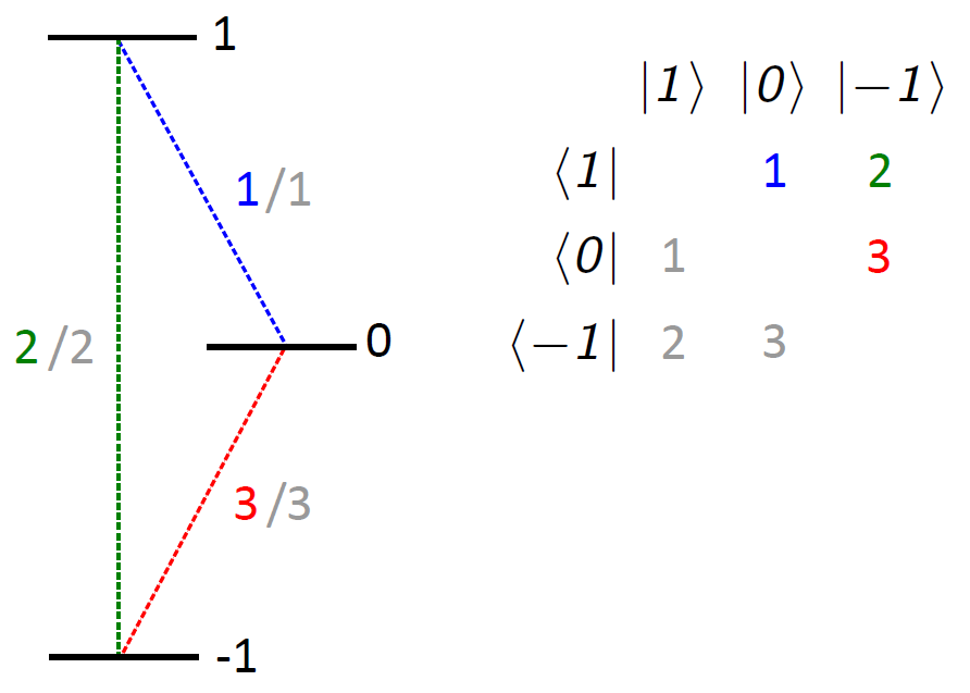

In systems with larger spin quantum numbers or several spins, relaxation times can differ for different types of transitions. If you do not want to use the same relaxation time for each transition, relaxation times can also be provided in matrices. To set up the input correctly, some knowledge of the spin system and the resulting density matrices is required: For a single-spin system the basis functions of the operators in the Zeeman basis state are in descending order, left to right (more at sop). E.g., an S = 1 system has three states and the three pathways connecting them can be described by a 3 × 3 (density like) matrix:
With this we can now design matrix input for T1 and T2, that can be translated into a relaxation superoperator:
Sys.T1(1,2) = 1.5;  % transition 1 (blue)
Sys.T1(1,3) = 0.5;  % transition 2 (green)
Sys.T1(2,3) = 1.4;  % transition 3 (red)
Sys.T2(1,2) = 0.3;  % transition 1 (blue)
Sys.T2(1,3) = 0.1;  % transition 2 (green)
Sys.T2(2,3) = 0.3;  % transition 3 (red)
Sys.T1 =
		0		1.5		0.5
		0		  0		1.4
		0		  0		  0
Sys.T2 =
		0		0.3		0.1
		0		  0		0.3
		0		  0		  0
It suffices to define the upper triangle only (as done above). But for longitudinal (not so for transverse) relaxation there can be a difference between "up" (|+1>→|0>) and "down" (|0>→|+1>) pathways. If you are interested in assigning different relaxation times for opposing directions, you can do this by using the lower triangle:
Sys.T1(2,1) = 1.3;  % transition 1 (grey)
Sys.T1(3,1) = 0.7;  % transition 2 (grey)
Sys.T1(3,2) = 1.1;  % transition 3 (grey)
Sys.T1 =
		  0		1.5		0.5
		1.3		  0		1.4
		0.7		1.1		  0
In case the lower triangle is not defined for T1, the upper triangle is used for up and down directions. Any transitions that are not assigned a relaxation time (matrix element 0 in the upper triangle), are automatically set to 1010 microseconds, which effectively switches relaxation off on that pathway. Relaxation times in the lower triangle of T2 are ignored.

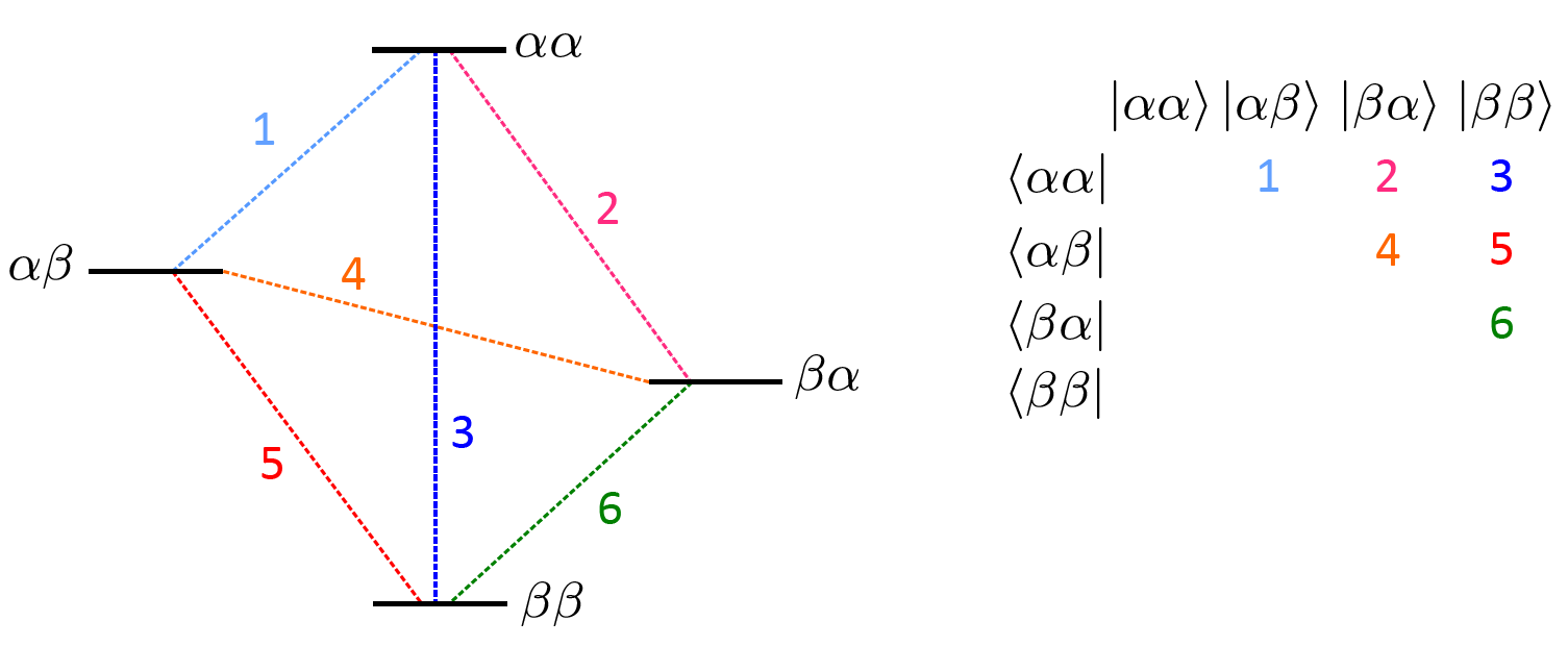

Spin systems that contain several spins are assigned relaxation times analogously, but require a slightly deeper insight into ordering of the states: The representation of the operators is in terms of product Zeeman basis states |m1,m2,m3,..>, where m1 is for the first spin, m2 is for the second spin, etc. The basis functions are again in descending order mi, left to the right. E.g. for two coupled (electron) spins with S, = 1/2, you get the following energy level scheme:
