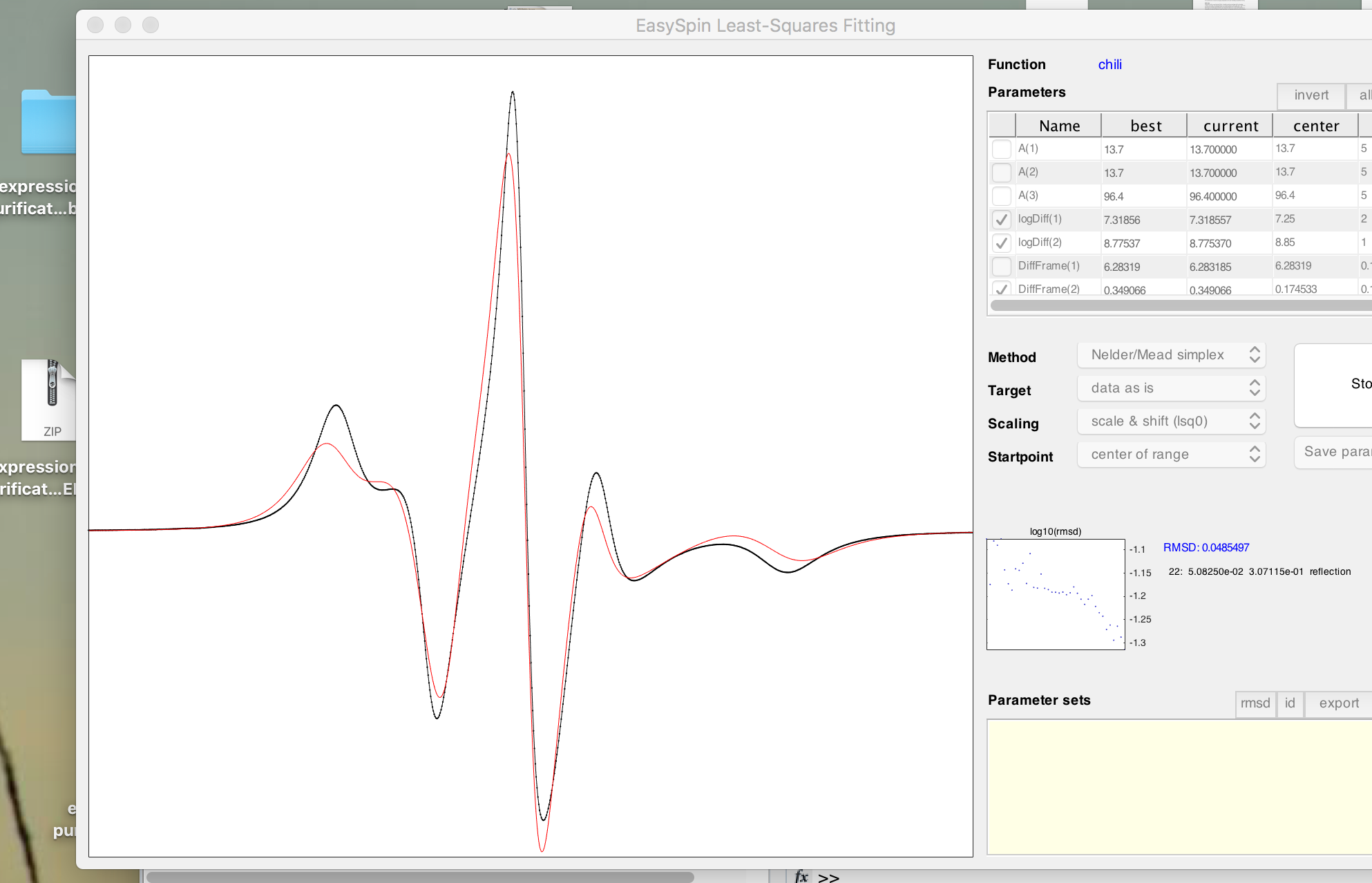

Attached is the example of the fitting I get
Screen Shot 2017-10-26 at 10.19.21 AM.png (321.8 KiB) Viewed 3436 times
Re: UIControl Callback
Please give the script and exp data which causes the eror. Or alternatively try to run fitting with Opt.Verbosity=2. It gives much more information.
Also make sure to test this with the latest version of EasySpin (see the website). If you are using an older version, it might be that this is a bug that was already fixed.
