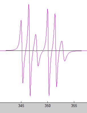

[x1,y1]=chili(Sys1,Exp);
[x2,y2]=chili(Sys2,Exp);
[x3,y3]=chili(Sys3,Exp);
Let's look the plot:
plot(x1,y1,'k',x3,y3,'m')
results in
It looks good, because the proportions seem to be ok.

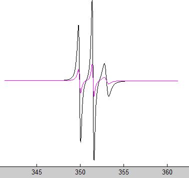

plot(x1,y1,'k',x2,y2,'m')
results in
In this case, the weights are equal so that the amplitude of the broad signal from Sys2 should be lower than the amplitude of Sys1. That is clearly not the case...

This is a non-obvious consequence of the convolutional broadening with a extremely narrow almost delta-like Gaussian.
You are using Gaussian convolutional broadenings of 0.01 mT in Sys1.lw and 0.04 mT in Sys2.lw. Your field increment is dB = 20 mT/1024 = approx 0.02 mT. So both one of your Gaussian lineshapes is narrower than a single field increment and will essentially look like a delta spike:
B = linspace(340,360,1023);
lw = 0.01;
y = gaussian(B,350,lw);
plot(B,y);
This leads to numerical problems during the convolution.
For now, you can fix this in several ways: (1) remove the Gaussian broadening - clearly not needed if it's really this small; (2a) make lw(1)/dB >=2 by increasing the FWHM of the Gaussian broadening; (2b) make lw(1)/dB>=2 by shrinking dB through increasing the number of points (Exp.nPoints).
In the next release, chili (as well as garlic and pepper) will detect this situation automatically and take care of it. Thanks for reporting!
