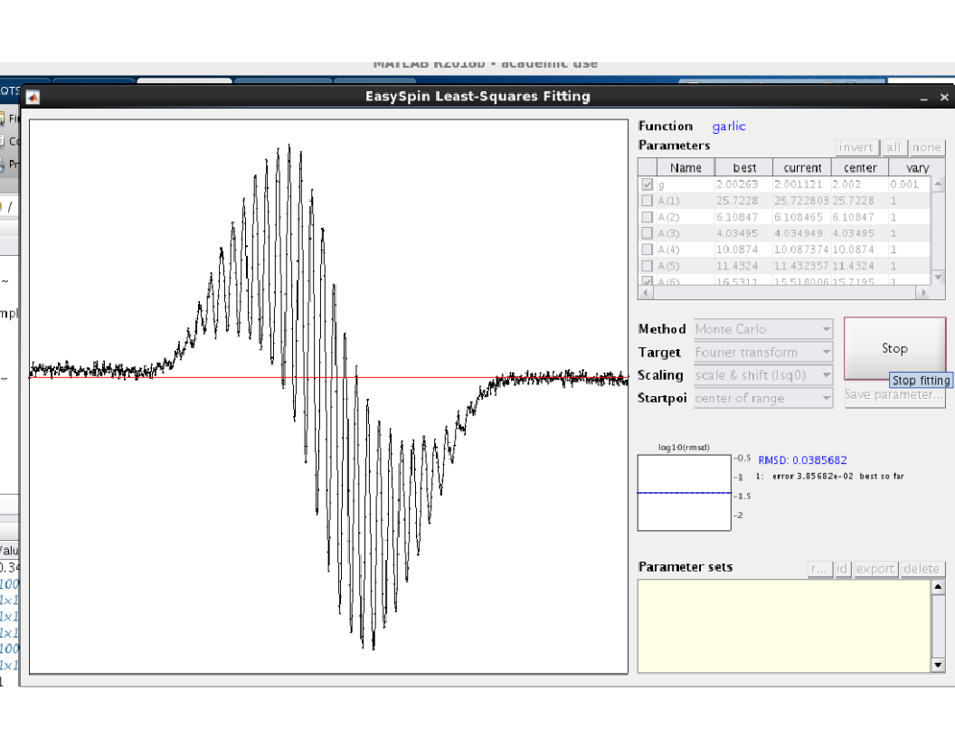

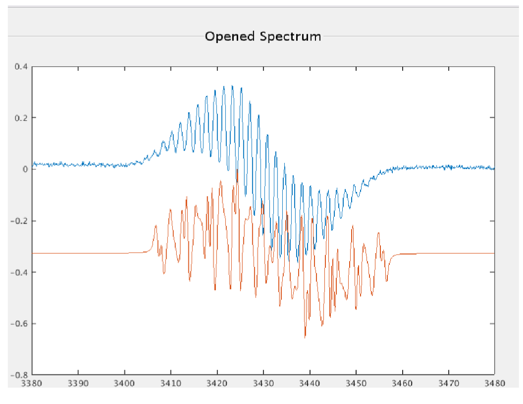

When using esfit (with garlic), the simulation spectrum is always a flatline in the GUI.
Garlic alone works fine (see below image), and typing 'easyspin' in the command windows doesn't give any warnings.
Has anyone encountered this problem before?
Not sure how to proceed now, should I try recompiling EasySpin or something?
