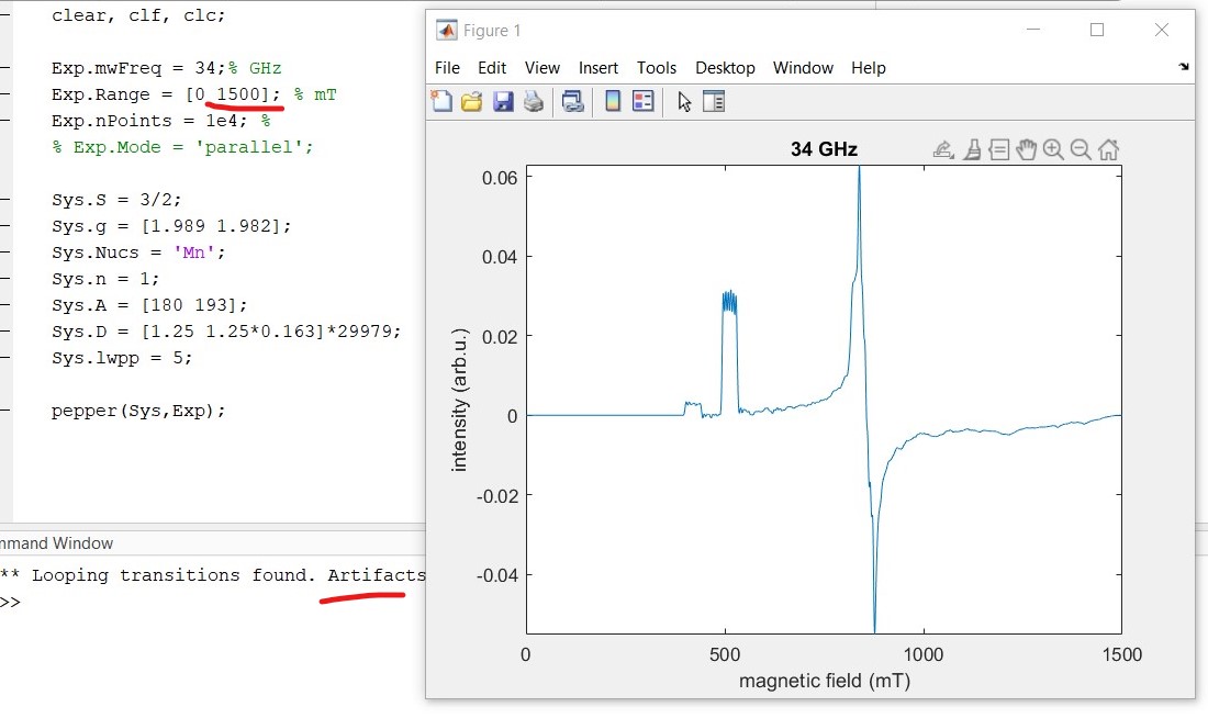

Post by YanQing »
I originally planned to see if there is any forbidden transition after 1.2T, but I zoomed in on the magnetic field and found that easyspin started to report errors.
Please fix this bug,
Thanks.

This happens when your spectrum extends past the field range and there are looping transitions.
To avoid this, enter a large field range, e.g. [0 6000]and a large number of points, and then zoom in.
