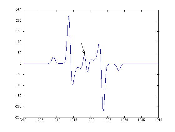

I am trying to simulate with easyspin the powder spectrum of a pair of electrons coupled by dipolar interaction. The simulation exhibits a strange line in the middle of the spectrum, which does seem to have any physical meaning (line indicated by an arrow on the attached file). I do not get this line with XSophe. Is there any reason why this line appears with easyspin?

Re: strange epr line in a dimer simulated spectrum
This is an artifact due to an insufficient number of orientations. If you increase them slightly (in Opt.nKnots), then the spectrum is accurate. Here is the code:
