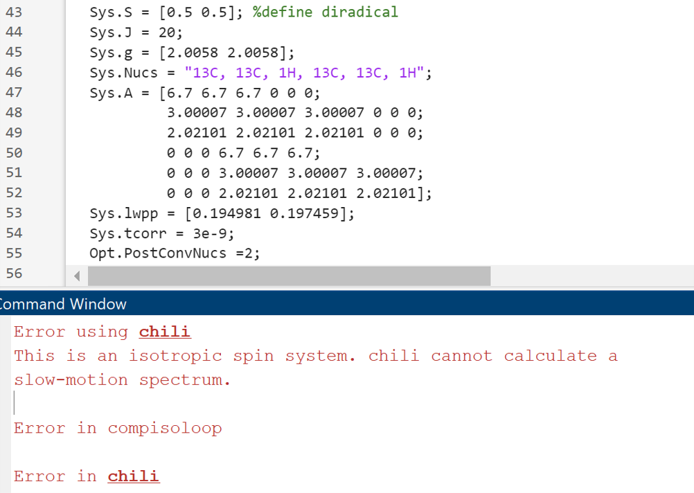

Hi all. Thanks for the reply. I'm currently experimenting with chili at the moment but I'm running into the error: This is an isotropic spin system. chili cannot calculate a slow-motion spectrum.
I've checked other forum post and I've tried to make it look similar but the same error still comes by. Any ideas? :?

by katarkon
What about pepper?

by ct821
I've also used pepper but I'm not seeing any difference in my signal if I set the Sys.S to [0.5 0.5] vs Sys.S to 1.

by katarkon
Use 1H nuclei only, drop down 13C ones and define the spin system correctly.
Sys.S = [1/2 1/2];
Sys.Nucs='1H,1H';
Sys.A=mt2mhz([aH 0.0;0 aH]/10);
that is expected if the g-values and all the couplings are the same.
