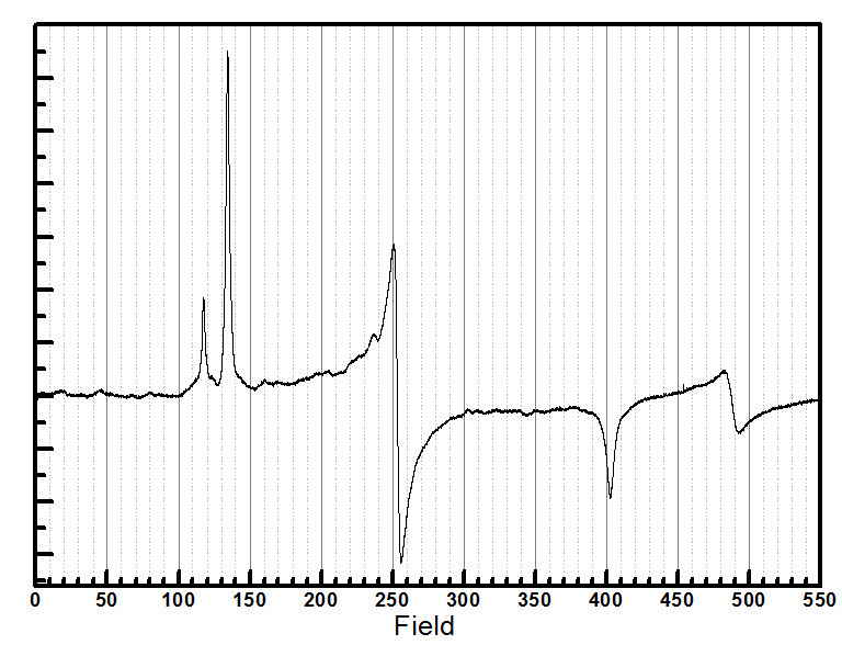

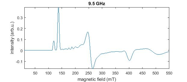

I tried harder and able to generate the spectra but not able to give the perfect strain so that i can match the intensities and broadening of the spectrum,
As given in documentation i can change either g/A strain or D/E strain
The problem is by giving any strain i am able to change the intensities but at the same time I am getting the broadening of peaks which i don't want.
I did doping studies and with the increase of doping i am seeing there is a peak broadening (PP width) and i want to reflect that in terms of strain.
You can have a look of my coding and Experimental spectra
Thankyou

Experimental Spectra
Expt Spectra.jpg (91.11 KiB) Viewed 2897 times
Generated spectra Cr3+ using easyspin
generated spectra.jpg (15.57 KiB) Viewed 2897 times
Re: Simulation of Cr3+ spectra
Hvae you tried to use HStrain?
