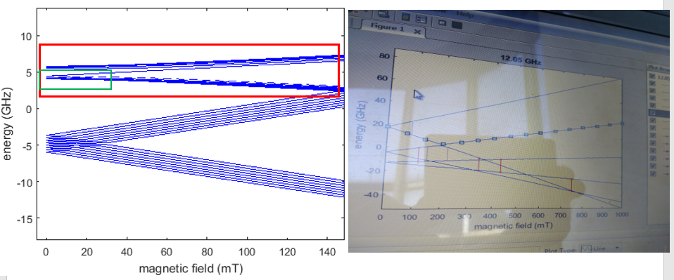

Thank you, it worked very well. I would like to know if it is possible to get the spin Hamiltonian matrix (or energy of different energy levels) denoted by the zero field splitting parameters( D, a, F...) when applied with a magnetic field along a specific direction.

Hi Stefan, do you remember i asked help from you about the right picture in attachment? You said it seems ok for you. But compared with Figure 2 in this paper
https://journals.aps.org/pr/pdf/10.1103/PhysRev.148.211
It seems in my plot , states|-5/2> and |3/2> have a mixture. But in this paper, it's |-5/2> and |1/2> have a mixture. My codes are as below,
mySystem=struct('S',5/2,'g',2.0029);
mySystem.D=5146.5;
mySystem.aF=[709.6 -112.1];
B=[0 1000];
Ori=[0 0];
Freq=12;
levelsplot(mySystem, Ori,B,Freq)
could you please tell me where's the problem comes from? Thank you.

- file.png (323.85 KiB) Viewed 3867 times
- Posts: 1127
Re: admiture of two spin states
Notice that in the paper the a term is in a coordinate system different from the D term, the F term,and the Zeeman term. This frame has axes (xi,eta,zeta), with the z axis along the [111] direction in that frame.
To activate this in EasySpin, use
Sys.aFFrame=3
, as shown in the documentation here.
