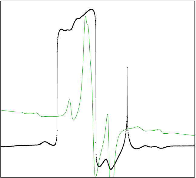

However, I seem to have problems with Easyspin's calculation of the baseline and/or the calculated spectrum (see image), or there is something I am doing wrong.

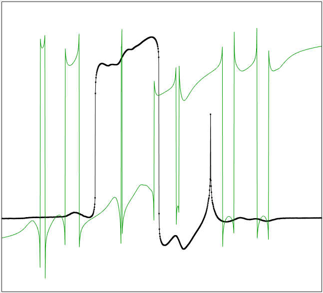

However, for the moment, I still get the regular EPR calculated spectrum.
It seems that the
[x,y] = pepper(fullSys,Exp,Opt);
y=sign(y).*log(1+abs(y));
declaration in the custom function does not return the modified result to the main script (see screenshot).

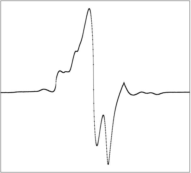

Re: Fit log scale spectrum
I found that I get a nice amplification of the weaker features by a square-root spectrum (i.e. spc = sign(spc).*power(abs(spc),1/2);), like below:

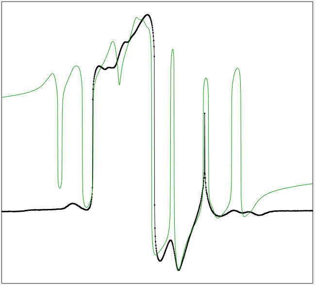

Indeed, that came in very handy. The 7th root gives a nice balance between weak ans strong features.
Now the issue is to correct the way the scaling is done. I think that the default algorithm doesn't know of the changes to the fitted curve and cannot properly treat it:
