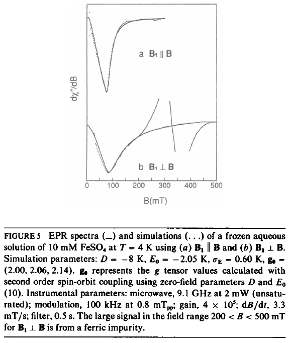

I try to simulate S=2 spectra from Fe II proteins, in parallel mode.
First of all I'd like to reproduce a simulation found in the litterature (Hendrich, BiophysJ 1989), Fig 5.a.
Here is the code I wrote:
Sys.S=2;
Sys.g=[2 2.06 2.14];
D=-8;%K
E=-2.05;%K
Sys.D=[D E]*0.7*29979.2458;%in cm-1 in MHz
Sys.DStrain=[0 0.60]*0.7*29979.2458;%K in cm-1 in MHz
Exp.Range=[0 300];%mT
Exp.mwFreq=9.1;%GHz;
Exp.Temperature=4;%K
Exp.Mode='parallel';
[x,y]=pepper(Sys,Exp);
plot(x,y)
Unfortunately, no resonance is found at 9.1GHz. E has to be increase to -1K to see something...
I can not understand why my easyspin simulation can not reproduce Hendrich's one and where I am wrong...
I would appreciate some help!
Thanks!

I have an experimental spectra that looks like the one in the figure 5.
Unfortunately easyspin seems not to be able to simulate this spectra... whatever the parameters are...
Moreover, I found some simulated spectra in the litterature. I can not imagine that they all are wrong...

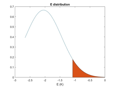

Sys.S=2;
D=-8;%K
E=linspace(-8/3,0,100); % 0<=E/D<=1/3
Opt.Threshold=0;
Opt.Sparse=0;
%%% E values leading to resonance field
for k=1:numel(E)
    Sys.D=[D E(k)]*0.7*29979.2458;%in cm-1 in MHz
    data{k,1}=resfields(Sys,Exp,Opt); %resonance position(s)
%%%gaussian distribution of E and intersection with E values giving resonance
probaE=gaussian(E,-2.05,0.6*2.3548);
index_res=~cellfun(@isempty,data(:,1));%index where resonance is found
plot(E,probaE); % E dsitribution
hold on
area(E(index_res),probaE(index_res))
xlabel('E (K)')
title('E distribution')
The execution of this code gives:
The colored edge of the distribution represents the E values with resonance.
Why ES and especially pepper does not take this edge of the distribution into account, even if no resonance arises from the central value of the E distribution?
Thanks for your help!
Re: S=2 simulations
I needed to brush up on exactly how ES was treating this.
Within resfields, ES is not explicitly calculating a distribution of D and E value when using Dstrain but rather an anisotropic broadening factor. So when the central feature, as is the case in your simulation, has no resonance there is nothing to broaden. In fact, the line broadening page in the documentation does provide a work around, which you've nearly reproduced in your above script.
Sys.S=2;
Sys.lwpp = 5;
D=-8;%K
Opt.Threshold=0;
Opt.Sparse=0;
spec = 0;
index_res = logical(zeros(size(E)));
for k=1:numel(E)
    [B,spec_] = pepper(Sys,Exp,Opt);
   spec = spec + probaE(k)*spec_; %resonance position(s)
   index_res(k) = any(spec_);
subplot(2,1,1); plot(E,probaE); axis tight
hold on
xlabel('E (K)')
hold off
subplot(2,1,2); plot(B,spec); axis tight
Choppiness is observed due to not enough sampled orientations or not enough line broadening.
