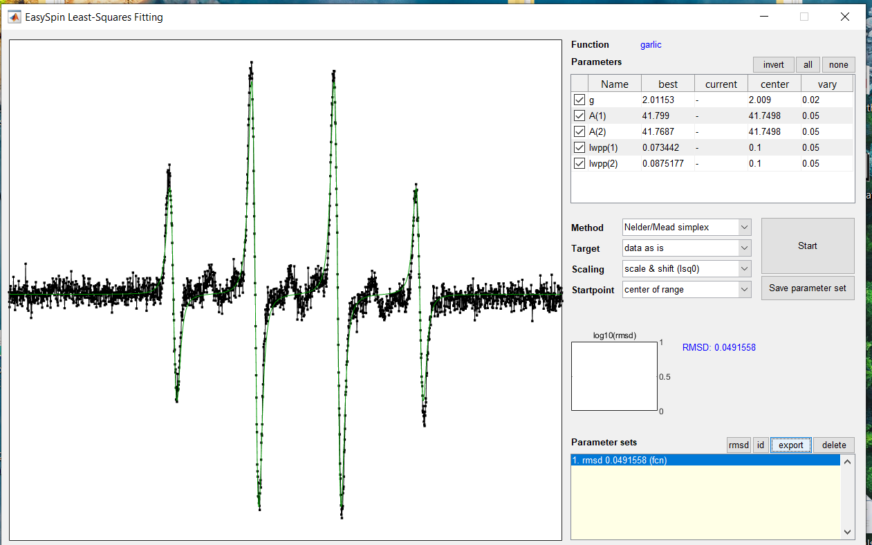

Dear Easyspin team,
My MATLAB fitting only shows RMSD, and no information about goodness of fit (chi-square specifically).
May i know if there is something wrong with the code i wrote? And how can i find the chi-square in this case?
Thanks.
Jennifer

Re: graphical user interface shows incomplete fitting results
It looks like you are running an old 5.x version of EasySpin. Try to use esfit from the latest EasySpin 6 release.
