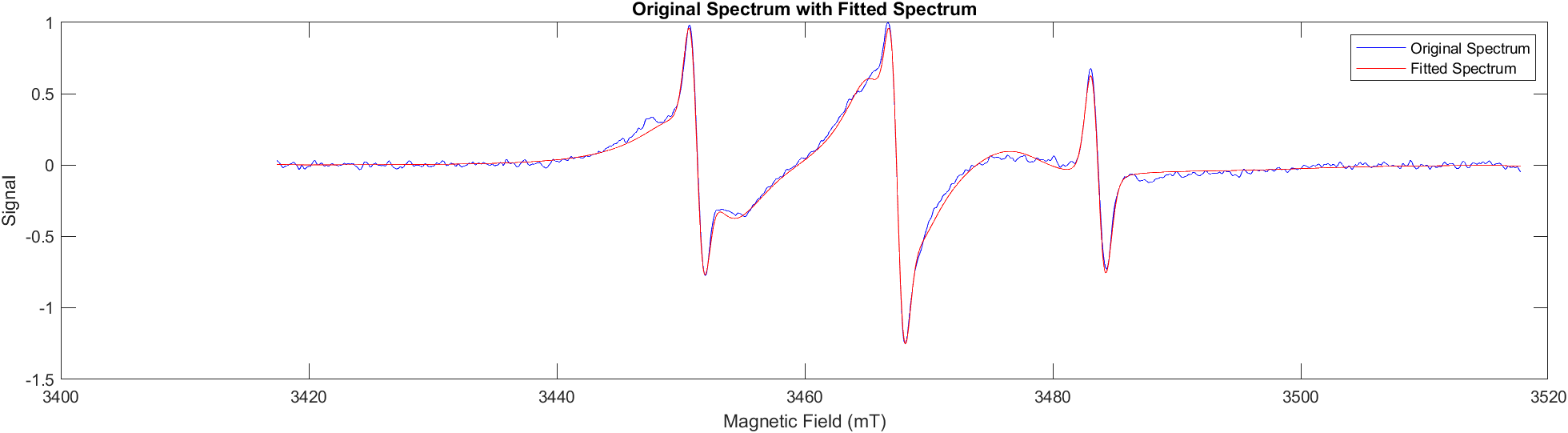

Hi, I am new user. I tried to fit two component epr spectrum. And I fitted the spectrum. but i am unable to separate the component. I used the following code to fit the data. can anyone please help me what coding instruction i need to apply to save the component separately? or what is the output file of fitted spectrum for two component? Please help me.

figure;
subplot(2, 1, 1);
plot(B, spc,'b-', 'DisplayName', 'Original Spectrum');
hold on;
plot(B,result.fit,'r', 'DisplayName', 'Fitted Spectrum');
xlabel('Magnetic Field (mT)');
ylabel('Signal');
title('Original Spectrum with Fitted Spectrum');
legend('show');
Residual = spc-result.fit;
subplot(2, 1, 2);
plot(B, Residual, 'g-');
ylabel('Signal');
title('Residual Spectrum');
data1 = [B(:) result.fit(:)];
save('Fitted Spectrum 126 2.txt','data1','-ascii');
data2 = [B(:) Residual(:)];
save('Residual 126 2.txt','data2','-ascii');
NB5_126_2 fitted spectrum.png (43.81 KiB) Viewed 19276 times

You may extract each parameter set from the output and simulate them separately.
