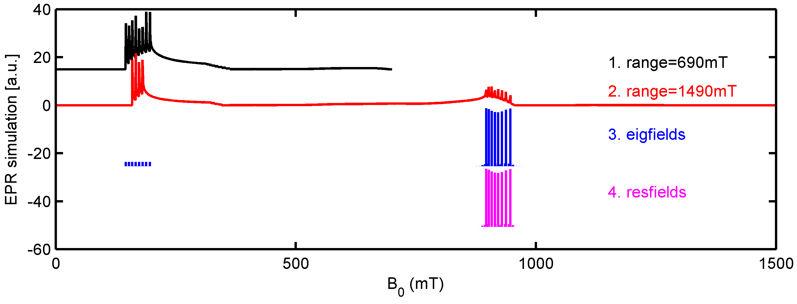

In the code below (plot attached) you can see different numbers of transitions present depending on the range specified. By comparing resfields and eigfields, it's clear that resfields is missing transitions in this case. Is it possible to run pepper with eigfields? Any examples of brute force code, if not?
thanks.
-Will

Re: resfields artifacts, pepper with eigfields instead?
Have you tried Opt.Threshold=0? This bypasses the automatic transition selection in pepper and resfields and forces ES to calculate all transitions.

Okay, RT(F)M, thanks. That was it. We know from field vs. freq. calculations there a huge range of transition probabilities, so it is exactly as I now see stated in the 'pepper' documentation.
