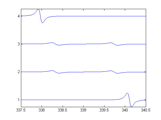

It should be expected that separate output of the function returns a set of the spectra with single line for each. But exchange() function in slow rate limit returns some spectra with several lines. Is any way to rid it out?

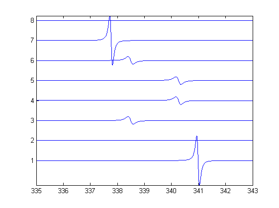

Yes, this idea should be working, although there are some problems with such 'hyperseparated' output.
Firstly, some zero spectra are generated. Surprisingly, in the case of fast exchange a pair of zero spectrum and line spectrum is generated instead of expected pair of equal spectra. Of course, the zero spectra may be easily detected and discarded :) However Opt.reduce parameter should be 0 for fast exchange and 1 for slow one to get the predictable results. More sadly, the removing of the duplicates works only for two-site mutual exchange (although its algorythm looks adoptable for more general cases).
Secondly, if nuclei with I>1/2 are used, the order of the spectra becomes unpredictable. I propose that the 'brute force' code will be working:
    idx = 1;
    for iLine=1:nLines
      for iSite=1:nSites
        % Calculation of spc_
        if separateOutput
          spc(idx,:) = spc_;
          [~,B0] = max(spc_); %approximate resonance position
          spc(idx,nPoints+1)=B0; %indexing the spectra by resonance position
          idx = idx + 1;
        else
          spc = spc + spc_;
      if separateOutput
      spc=sortrows(spc,nPoints+1); %sorting
      spc(:,nPoints+1)=[]; %removing indexes
two 14N nuclei, slow exchange, reducing on
slow exchange, reducing off
fast exchange, reducing on
