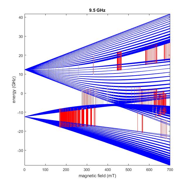

Thanks Stefan. Actually I was trying to understand the powder spectrum by considering all possible orientations. I am not sure if it is right. I think I would need some scaling factor. The figure is attached herewith.
%test example for EPR transitions
clear all
Param = struct('mwFreq',9.5,'Range',[0 700],'nPoints',2048);
Param.Temperature= 10;
Sys = struct('S',3/2,'g',[2],'lw',[1]);
Sys.D = [0.413 0.011]*29979; %MHz
for i = 0:0.1:pi/2
for j = 0:0.1:pi/2
Ori = ;
levelsplot(Sys,Ori,Param.Range,Param.mwFreq);
hold all;
