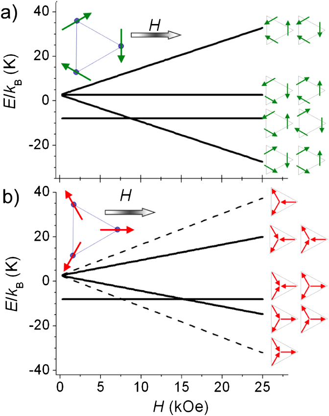

I am interested in anisotropic exchange in molecular magnets. I am able to rotate the local tensor frame for anisotropic g and zero field splitting terms. However I do not know how to tilt tensors associated with anisotropic exchange. An important example would be the ising model applied for the interpretation single crystal of magnetization of Dy3 (Phys. Rev. Lett. 100, 247205). I make an attempt to reproduce the characteristic Zeeman splitting diagram (fig 3)

Zeeman energy of Dy3 molecule

Thank you for your comment. I am familiar with levelsplot. I should be clearer in my question; the code does not match the desired field dependence (i.e. a double degenerate singlet ground state at low field, like a) of the attached figure). This is most likely due to the required rotation of the anisotropic exchange. Could you please tell me how to show the following expression by the easyspin spin system: j_zz * S_zi * S_zk (the S_zi is equal 1/2, but S_zi is not parallel with S_zk)? Thank you.

If what I have so far understood is correct, the gFrame that turns logal g-tensors like the green arrows indicate is:
Sys.gFrame = [0 90 0; -30 -90 0; 30 90 0]*pi/180;
and the way the red arrows indicate it is:
Sys.gFrame = [90 90 0; 60 -90 0; -60 90 0]*pi/180;
If I am correct, I hope this helps.
