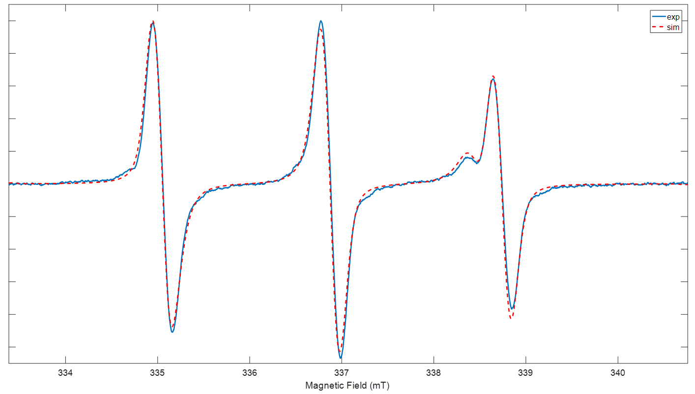

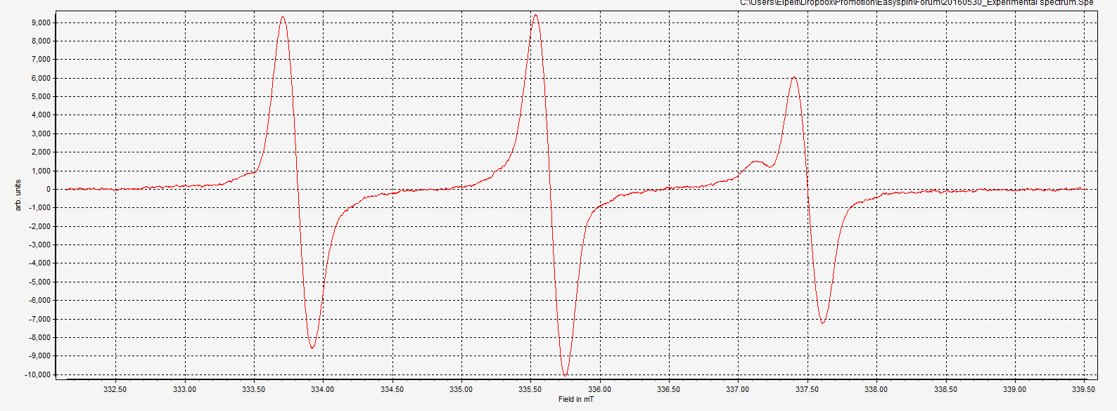

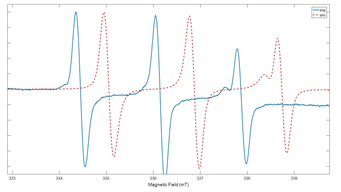

For better understanding, I attachted images of my experimental/simulated spectra in 1. MPlot (MS400 software), 2. Easyspin version 5.1.11 and 3. Easyspin version 5.2.11 as well as the associated .spe file.
The magnetic field axis in the Magnettech software is different to the Easyspin one (both version). But the magnetic field of the experimental spectrum also differs in the both easyspin version. The illustration of the simulated spectrum is in both Easyspin version the same. So, it seems that the experimental spectrum (.spe format) is illustrated in the new easy spin version in an other way compared to the old one. I have the same problem in all my files so far.
Do you know what I can change in my mathlab file to obtain the experimental spectrum in the new version that looks in the same way as in the old version?
I would be thankful for your help.

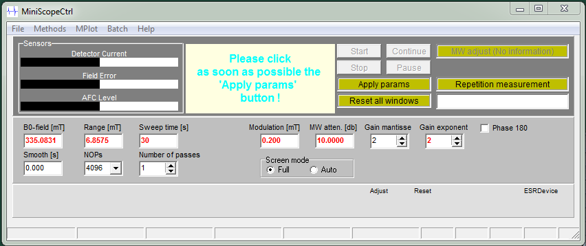

This inconsistency is puzzling. What are the settings for the center field and for the sweep width in the MS400 software? The latest EasySpin version gives:
Are all the other parameters (attenuation etc.) consistent with what is shown in the MS400 software?

Re: magnettech SPE file in ES 5.2.11
I checked the parameters in my easyspin version and in the MS400 software. They are all in accordance with your parameters of the latest EasySpin version.
