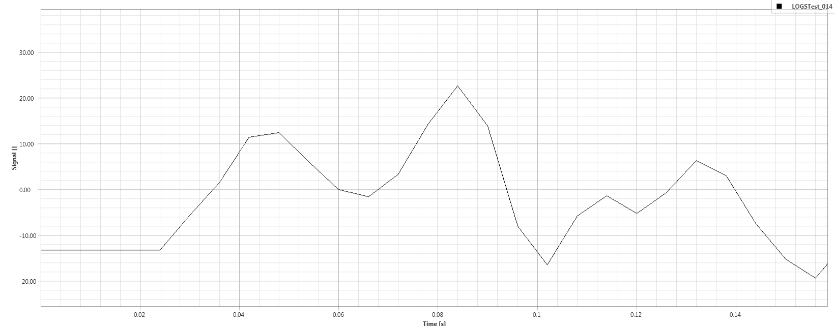

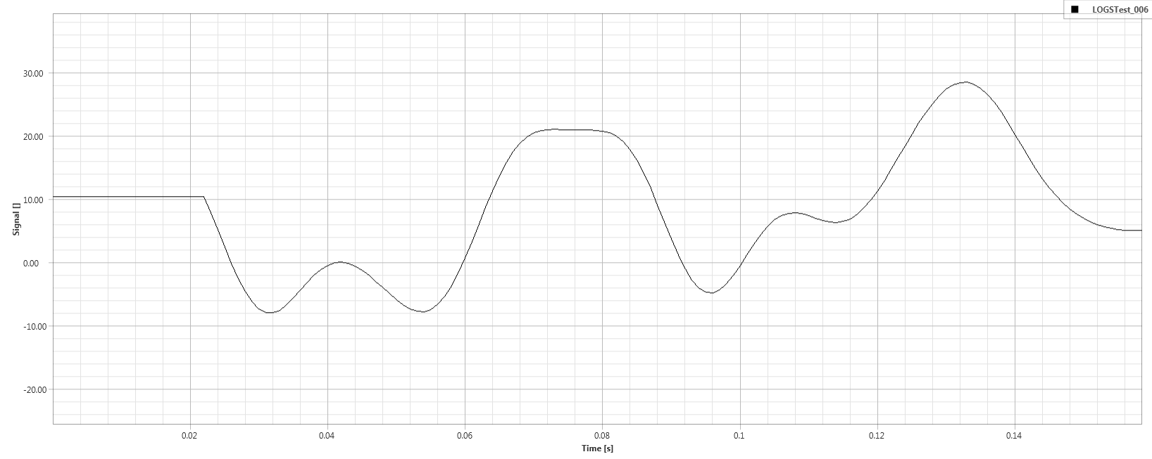

is in the works. Question regarding LOGSTest_006_transient: the first time point in the file is at 0.022 s, but the screenshot appears to show the data starting at 0 s. Is ESRStudio extrapolating to 0?Re: Magnettech MS5000 transient measurements - wrong x-axis
Apparently, the y data at t=0 s is just a copy of the value at t=0.022 s. Please see the attached screenshots.
