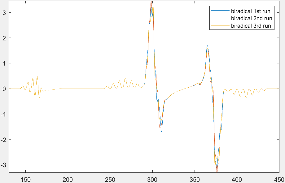

I also noticed that each new calculation of the biradical spectrum in the example above gives noticeably different spectra. How is this possible?
%EasySpin 6.0.0-dev.30
clear, clf, clc
Exp.mwFreq = 9.5;
Exp.Range = [130 450];
Exp.nPoints = 8192;
Opt.GridSize = [99 3];
g = [2 2 2];
Axy = 70;
Az = 200;
D = 2000;
J = 1e10;
lw = 3;
Nucs = '63Cu,63Cu';
SysB.S = [1/2 1/2];
SysB.g = [g; g];
SysB.A = 2*[Axy Axy Az 0 0 0; 0 0 0 Axy Axy Az];
SysB.Nucs = Nucs;
SysB.J = J;
SysB.dip = 2/3*D;
SysB.lw = lw;
[B,specB1] = pepper(SysB,Exp,Opt);
[B,specB2] = pepper(SysB,Exp,Opt);
[B,specB3] = pepper(SysB,Exp,Opt);
plot(B,specB1,B,specB2,B,specB3);
legend('biradical 1st run','biradical 2nd run','biradical 3rd run');
axis tight;
It seems to me that in this case it will be problematic to determine the Spin Hamiltonian parameters of the experimental spectrum...

With regard to the spectra being different each time, ES adds a little bit of noise to the Hyperfine values in order to break potential degeneracies when doing the full matrix diagonalization.
