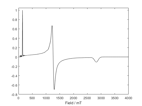

Hi - I'm new to the forum, but hopefully this is the place to report a bug in easyspin-6.0.0-dev.30 in pepper.
I get a normal S = 1/2 spectrum for the code below in the current stable version (5.2.30) and the development version I was using (6.0.0-dev.26), which is about to expire. I have just swapped to the latest development version (6.0.0-dev.30) and running the same script I get a lot of artifacts, most noticeably between the g1 and g2 features.
Code:
Test.m
(504 Bytes) Downloaded 621 times
Stable version:
Bug in easyspin-6.0.0-dev.30:

Re: Bug in pepper easyspin-6.0.0-dev.30
In 6.0.0-dev.30, the field name for specifying the powder integration grid has changed. Use Opt.GridSize = [91 6] instead of Opt.nKnots = [91 6], and it should work.
