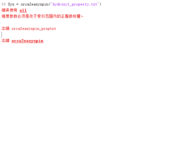

Hello everyone:
Recently, I practiced the epr calculation of hydroxyl radical present in the EasySpin offical website by orca 5.0.3, this work was normal termination. But when i loading the output file (hydroxyl_property.txt) using the easyspin 6.0.0_dev.51 in matlab R2017b , i suffered the following error. How can I solve this problem? Thank you in advance.
Re: Unable load output file generated by ORCA using easyspin 6.0.0_dev.51
Unfortunately, I can't read the error message.
Is the file on your path? What do you get with which hydroxyl_property.txt ?

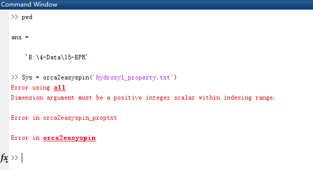

Hi! Dear Stoll, thank you for your reply.
The file hydroxyl_property.txt is in the directory E:\4-Data\15-EPR. The error message was changed into English, sorry for my careless. Could you help me solve this problem. Thanks a lot.

I think the problem is that in
orca2easyspin_proptxt
at line 123 is written
if ~all(A_vecs==0,'all')
. And the use of
all(A, 'all')
is only available for Matlab R2018b and later. So you should get a later version of Matlab.
Thanks for locating this problem! We will revert to syntax that is supported by older MATLAB versions.
